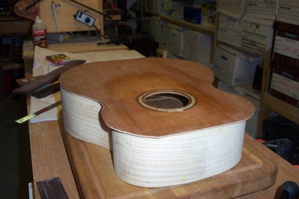

Here is some pics, the sides were already bent, the reversed kerfed linings glued in and so were the neck and tail block

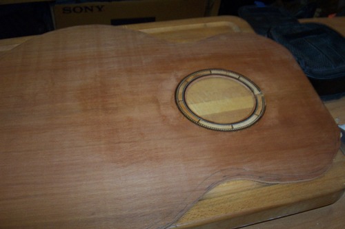

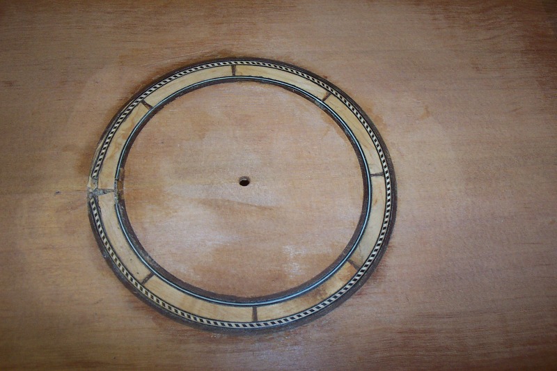

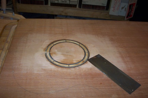

Here's the completed rosette scraped flush

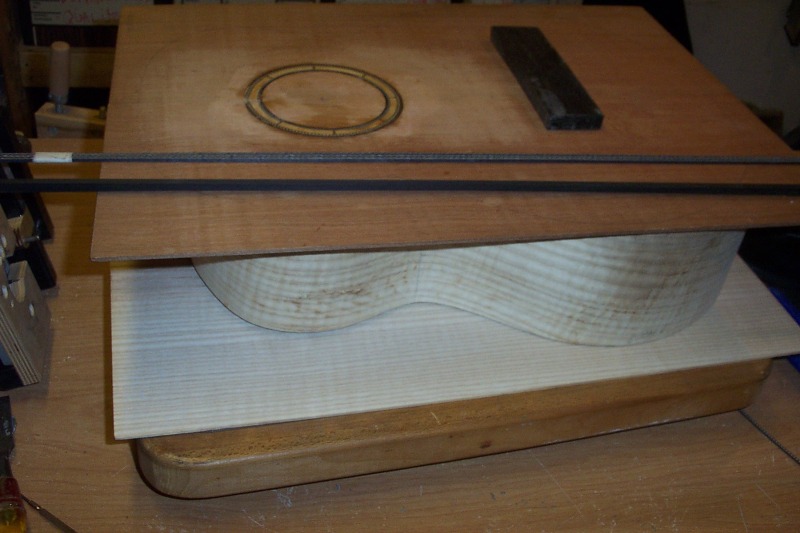

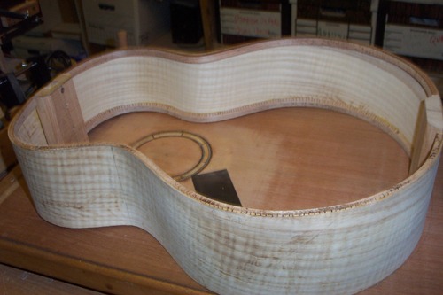

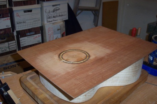

the white ash rim, i know, i'm not going to glue it like this!

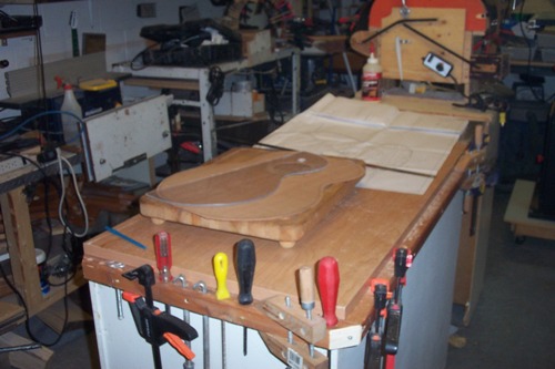

Here are some of the components that will make the appointments of that guitar

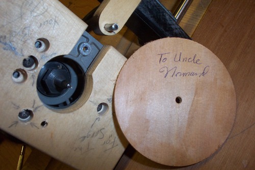

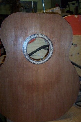

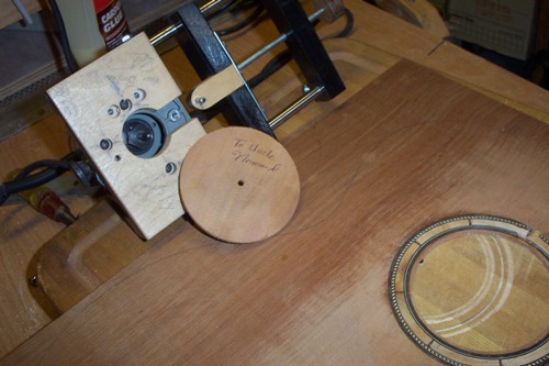

the cutting of the soundhole with Rod's amazing jig!!!!
Thanks Again Rod!

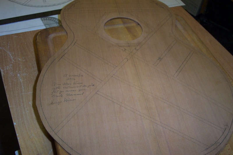

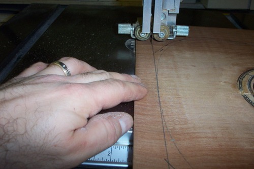

Cutting the contour of the top plate, i decided to cut what will be the center seam for the white ash back
et voila...

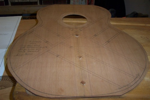

Tracing the braces on the undertop

I really dig that rosette. It is a pretty shape. Are the wooden pieces maple? That ash looks great!

ditto on the rosette Serge, looking good my friend.
PostPosted: Sat Nov 18, 2006 2:49 pm
Thanks Homey and Mike, the rosette is EIR and maple pieces with rope purfling towards the outer ring and BWB inner ring
Oh and BTW, that white ash taps really nice and really bends like butter!

Is that an SJ? Looks good bro

Yup, an OLF SJ with Michael Payne's original mold and plans, it is a treat to work with these!

Thanks Sam, ash has been the easiest thing to bend for me so far, really went easy and no cracks whatsoever and even the sides tap really nice!
